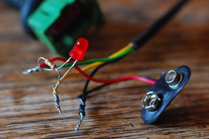

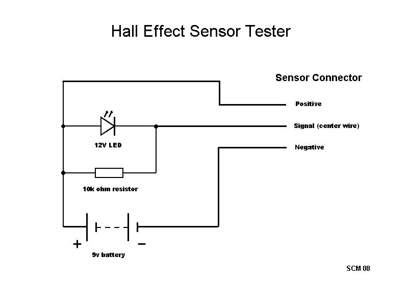

Be careful with the multimeter if you have electronic ignition! The multimeter/ohm meter static timing method, which is safe with points, can kill dead the hall sensor inside the bean can on electronic ignitions. Building a hall tester with an LED and using that to set timing statically is much safer for these delicate bits.
