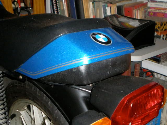

I've been looking to replace some pin stripes on my seat cowl.  I found some 3M tape at Pep Boys that looks adequate, but sure would like to get some advice from experienced hands.
Something like this? The tape's sizes and spacing is very close to the OEM BMW paint striping. Positioning is as stock.
I did both the tank and tail piece in the original R65 layout. The 1983 bike is 501 blue. I had originally considered white stripping but it looked rather garish to me. The final choice of silver offers a subdued look. I feel the color adds an elegant touch without too much "bling". Certainly does a fine job of defining the R65's snazzy fuel tank.
I ustacould run a sword striper brush and a can of 1-Shot fairly well but it's a skill that has to be practiced often to maintain proficiency.

It looks beautiful, Monte.  Did R65's have a double stripe?
Oh, yes, quite right.  My 1981 R65 is still dressed in its original colors; black with a white and red pinstripes on the fuel tank and tailpiece. Although the stripping is buffed nearly off the fuel tank in the knee grip area, it's a touchstone from three decades ago. I would not have the heart to repaint the bike.
