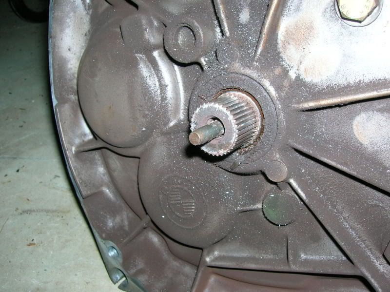

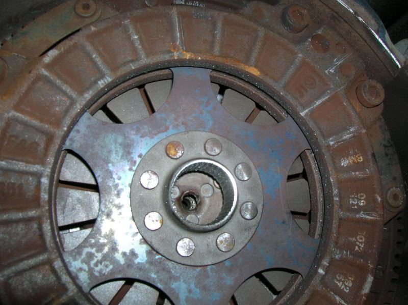

OK, I *finally* got around to digging into my suspected clutch spline failure problem on
my 82 R65LS, and the "good" news is that my diagnosis was correct.  The bad news
is that my diagnosis was correct, *and* the transmission input splines might also be
damaged sufficiently to warrant repair/replacement.   As I haven't looked at many
BMW tranny splines, I'm asking input from you folks.   If it doesn't look decent/acceptable
(I really don't want to get stranded with another premature failure again) then I'll bite the
bullet and buy a rebuilt transmission and put that in until I get the gumption to rebuild
this one with a new input shaft.
Lesson learned - when buying a bike from someone who left it in "storage" for 15 years,
don't assume that you can just replace all the cables, changing all the fluids and filters, replace
the shocks, rebuild the forks, slap some tires on it, tune it up and ride for 1000 miles before
opening her up to check the splines.   They were absolutely bone dry and there was alot of
rust and metal shavings in the clutch housing when I get her apart this afternoon.
Photos below:
Clutch splines worn down to slightly bumpy inner hub

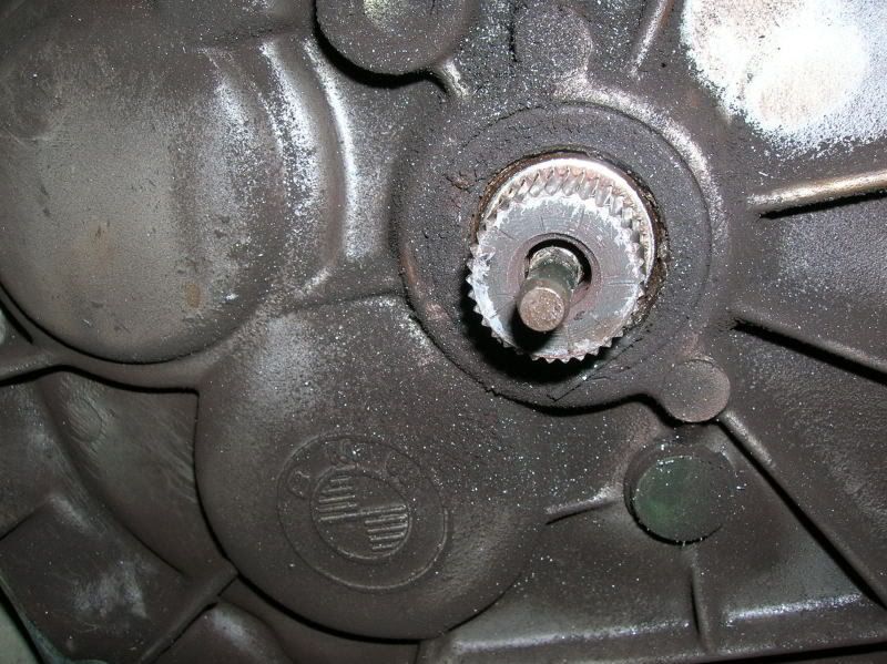

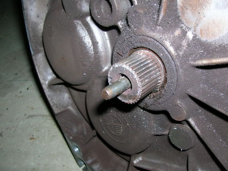

Transmission input shaft spline closeups for your review/input on acceptability..
They definitely have some peak flattening (not "pointy" triangles in profile) and
the height of the splines "flares" up to about ~ 1mm or so more near the transmission housing.
I can take more photos if necessary.

Aack!  They do look to have some height knocked off 'em, probably time to look for a used one.  Here's a shot of the splines from the '82 R100RT tranny I put into my '95:

Looks like a transmission overhaul, or a second hand transmission purchase is in your future. I guess this could be a poster picture of why spline lubes need to be done on a regular basis, and why this needs to be one of the first projects to take on when you purchase an airhead bike.  I checked on a price for the input shaft, and normal dealer price is $299, Chicago BMW $239, throw in a transmission overhaul for about $4-500, and it's probably going to be more cost efficient to get a second hand transmission. Also $100-125 for a new clutch disc. How many miles are on the bike?

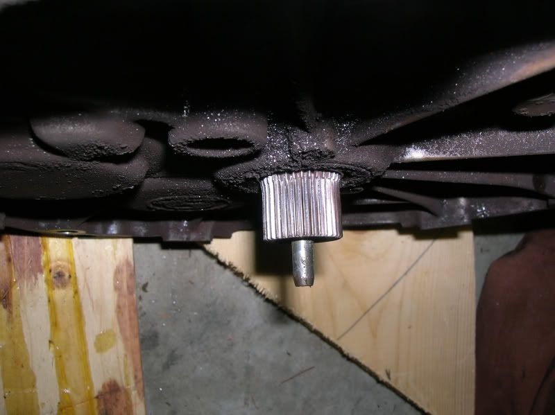

Here is another closeup view of the trans input spline, that gives a better view of how
the height of the splines are worn down.   A new/good unworn spline would be a consistent
height across the width of the spline area on the shaft.   Here you can see a very definite
wear pattern where it ground off all the clutch input splines.   A couple folks have told me
that this can be what splines look like usually after closer to 80K miles or more.  Most all those
rusty and shiny particles on the housing are indeed metal, from you know where..

I've got just a little under 80,000 miles, and the splines are no where near that worn, I couldn't see any 'step', worn in the splines.
