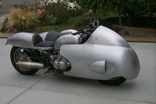

Melena, if the heads have not gone out, and Mike doesn't have a love-affair with his guy, I HIGHLY recommend taking them to Bob Grauer.  408 248 9732
rgrauer at earthlink.net
He is a retired machinist, and a real sweetheart of a guy.  He loves building and working on airheads, and does HIGH QUALITY work!
Bob's sidecar rig - that he built!
and you know I make my pictures "clickable"!
