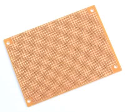

Could this be a copper pad like those used on electronic kits:
Sergio
  • Posts: 9124
Re: Engine breather hole
« Reply #9 on: March 22, 2010, 04:33:12 PM »
No, what was called out for in the article, was a common pot scrubbing pad made of shredded copper a lot coarser 'strands' than steel wool, used to clean dishes, and cooking pots .
You get them at a grocery store or similar retail outlet .
