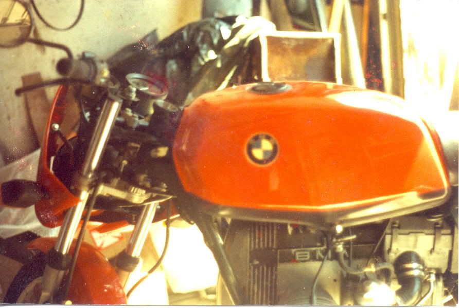

Sue (and all)
I have a photo of my LS with the top yoke removed, and the whole front end dropped
for cleaning/greasing the steering head bearings.   Aside from the top yoke and handlebars and black
plastic cowling, everything else is still attached (though the inside black plastic fairing pieces are
also of course removed and the fairing bolts are loosened.  I meant to scan the photo (I only have
the "hardcopy") and send it to Sue and you all but my #$%&! scanner died yesterday.   If I can
borrow a neighbor's while mine is getting repaired (sometimes those $20 service plans pay off)
I'll try to get it out - not a step by step thing, but from the photo you can hopefully tell that it
can be done without totally disassembling the bike.  I will say though, you need some way to support the
bike (both pieces are heavy) and unless you are fairly strong you may need help getting the
two bits carefully back together.

« Reply #7 on: April 07, 2007, 01:57:22 PM »
Hopefully this will work,  I get rusty when I don't do things periodically...
This link should get you to where I've managed to scan a couple pictures
and upload to photobucket..
http://s159.photobucket.com/albums/t138/nhmaf/
Unfortunately the photo quality wasn't the best, and the scanner is pretty old, too.
But maybe you'll get the idea..  If you look closely, you can see the lower tapered
roller bearings just below the steering head.   There is, of course, an upper set but I
couldn't find any more photos from that operation - sorry !  If I do come across more
photos hiding in the garage I'll post them too.  I'd *highly* recommend pulling the
fuel tank off, or at least sliding it back.   We didn't dent it while doing this, but I can see
where it would be very easy to do - the front end is kinda heavy, and when you have
the handlebars loose and flopping, things can get hit.
You'll want to have something sturdy to help hold up the front end, and I'd put some sort of
wood blocks under the bike frame if you don't have it strapped onto a bike lift.   It can be a bit tippy
in this condition.   I believe that we used a coated bungee cord or something to help hold the
handlebars/front end.   If you do this yourself, we'd all benefit from having better photo-documentation
of what you did, Sue !!  Best of luck !

The pics help. thanks

Thank you so much Mike.....Rob is right....a hanging at dawn!  BTW. my steering was sweet last summer. Bike sat too much and now has problems...so this can happen quickly...I just hope it is dried grease not the bearings shot. Bike's hate to sit!
