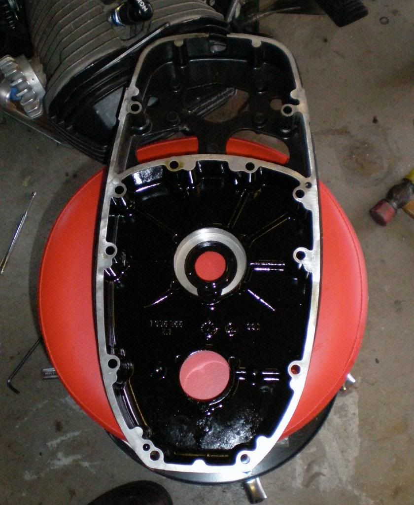

Stupid is.....the bottom two bolts are in the timing chain cover not the front engine cover...Dooh theres slight discoloration on the engine case from oil but no visible leaks  phew

« Reply #6 on: February 13, 2010, 04:56:33 PM »
There is a 28x47x7 oil seal in the Timing case Cover for the crankshaft ball bearing. Getting to it is a real PITA. I would expect a larger amount of oil with a seal failure. Hope it the bean can O-ring...   Monte
