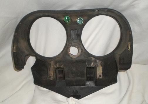

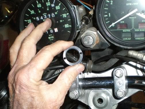

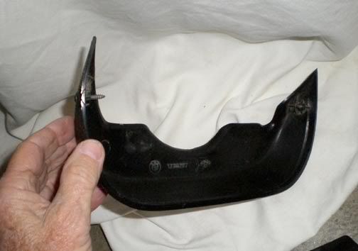

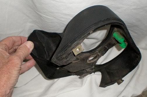

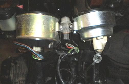

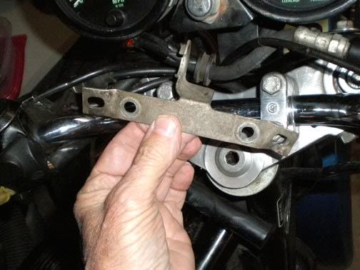

I'm in the late stages of replacing the steering head bearings on my 1983 R65. As the dash pad is yet to be refit, here are some photos of my disassembled dash and gauge components. Identical to my/your '81 R65s.
This bracket is anchored to the two forward handlebar clamp bolts. An O-ring on the brake hose is secured to the bracket and holds it in position under the upper cover, aka: the cow's tongue.
Top cover. Note the two metal tabs that capture the sheet metal screws on the lower cover.
Another view of the top cover. Note the spring clip in the metal tab. The clip passes through the outer holes on the brake cable bracket. These also help hold the two plastic covers together.
Lower cover. Two sheet metal screws with trim washers on left and right sides.
This threaded ring secures the top cover at the ignition switch location.
Tachometer and speedometer each have two threaded studs. The instruments are each secured with two small nuts. The "cathedral-looking" upper part of the complex metal plate is a component of the headlight mounting ears and the turn signal stalks.
It is rare to find a complete upper and lower plastic instrument shroud that does not have some sort of damage. My '81's cow tongue was in bad shape so I dumped it in favor of a Trail Tech digital instrument.
