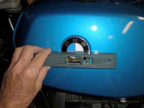

I'm outta the heavy work and into the fun stuff with the repaint on the '83... finally.
Earlier, I had used dental floss -the thinner, stout style- to saw off the tank and tail farkles without damaging them. Of course, this renders useless the OEM foam/sticky tape backing. Silicone RTV adhesive is the weapon of choice for replacement. The RTV adhesive does give you some time for adjusting the roundel's position.
Side bar note: I never have liked the sticky back material on the current BMW roundels. Usually, once the adhesive touches the sheet metal, that's it. You're stuck; level or not. Anyway...
For the fuel tank badges, I visually leveled the bike with some scrap wood under the rear tire. Squeeze a thin bead of adhesive about 1/4 to 3/8-inch inside the perimeter of the badge. Leave an adhesive gap at the bottom for a moisture/condensation vent.
Position the badge, press down gently -don't want any goop squeezing out around the edge- and visually level the roundel. Confirm the position using a small level placed parallel with the crossbar in the logo. A lightly applied strip of blue painter's tape -less aggressive adhesive- holds the badge until the adhesive cures.
I attached the tail piece roundel using the tried n' true TLAR method.

Re: Tank Badge Reinstall
« Reply #1 on: July 24, 2009, 11:12:33 AM »
Golly that new blue paint looks sharp with the blue of that roundel!  I have some new roundels on order to replace my very brown originals.

« Reply #11 on: August 26, 2009, 10:54:11 PM »
Here's how I got my new emblems on straight.  First, stick some conventional masking tape on either side of the dimple.  Mark the level line, to line up with the horiz. line on the badge.  Then, before peeling off the protective paper, hold the badge in place and use a 6-8 inch piece of duct tape to create a hinge/flap that comes about half way across the badge.  If you want, you can add another strip or two of duct tape to be sure the badge is held where it should go.  Then, lift the badge away from the surface, peel off the paper, and if you've been careful, the duct tape should let you bring it back to the exact right spot.
