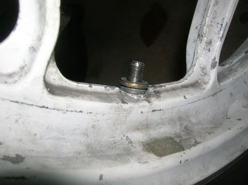

I guess I'll just order a couple of name-brand non-natural rubber tubes and deal with the results.  I see no reason why the secondary nut (as shown in the above pic) can't be removed...

The rim is about 1/2" (I didn't take an exact measurement) thick at the spot where the valve stem goes - that's just stupid in my opinion...

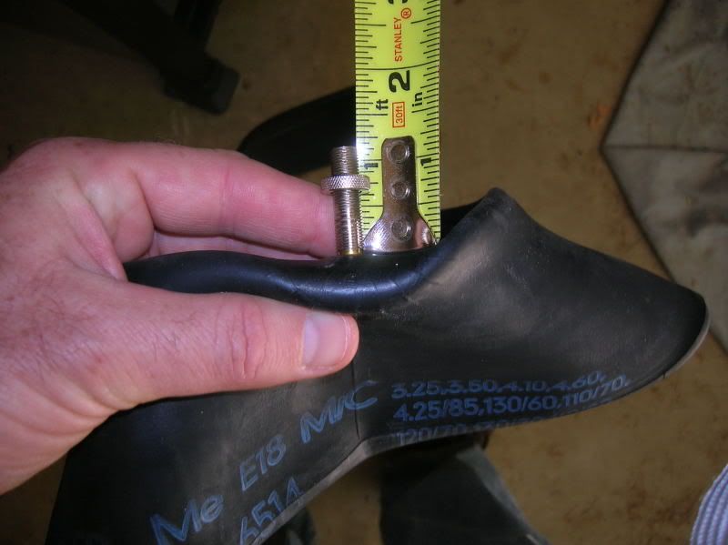

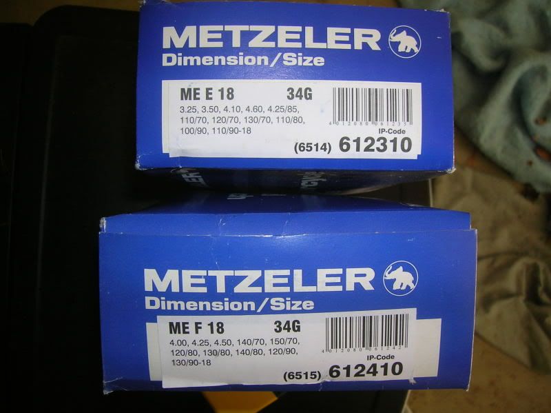

OK, I finally found my spare boxes of tubes and took some photos -
These are the Metzler tubes that I am running in my LS - the top (small box) is the front tube, the bottom (large box) is the rear tube.
The stem length on these is right around 1 and 1/8" long:
When installed in the bike, there is a bit under 1/2" protrusion above the rim, but if I totally remove the stem nut I can get about 1/2".
I keep the stem nut up against the valve cap and not tightened against the rim when riding.
(Monte "  my eyes, my eyes!" Miller should not look at this pic due to the sad state of my LS wheels - they are as bad or worse than Justin's right now)
I don't seem to have any problems with getting air into these using my standard air compressor.    I carry a spare front tube as it is a bit smaller/compact, will fit the front and will also easily expand enough to fit the rear if needed.
hope this helps
Mike

I'm not familiar with LS rims, but is there some sort of bushing that goes through the rim, or is that part of the valve stem nut under the knurled part ?
The 'snowflake' rim doesn't have that part.
