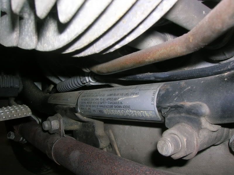

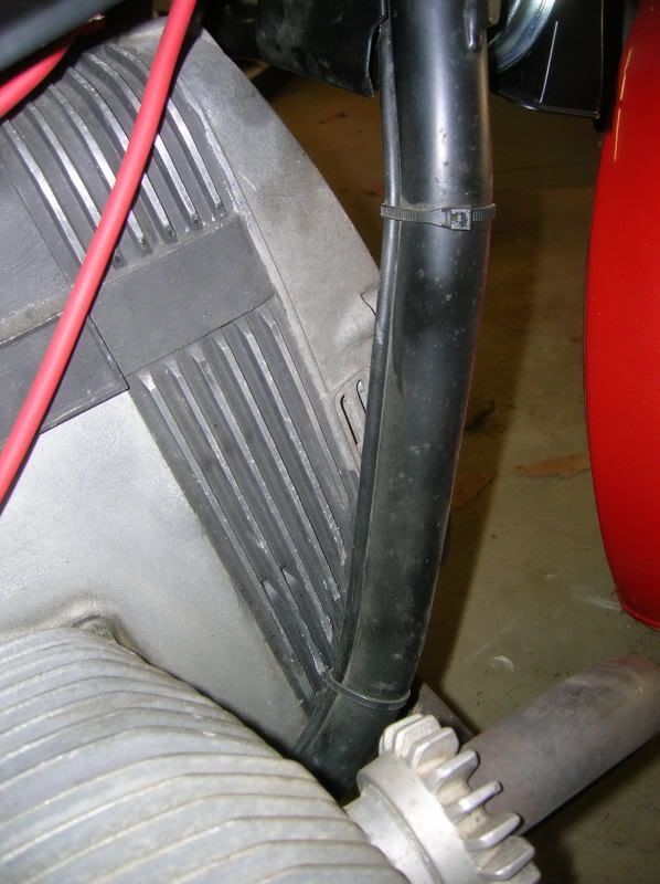

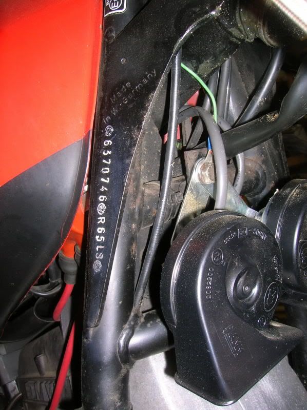

OK, here are the pics of my clutch cable routing.
Up near the top frame cross tube - it is the black cable in the middle of the pic coming down from the steering head and going behind the cross tube:
The cable is secured to the downtube along the 'top' inside:
And then a straight shot back to the engine casing boss:
This is how the OEM cable was routed on my bike when I bought it from the PO.   I removed the tall USA bars and put on low euro bars, and had to get a shorter OEM cable in the process.  IT is routed the exact same way and works well with no binding.

« Reply #5 on: May 26, 2009, 06:07:51 AM »
Thanks for the pix, I have changed my cable routing to the same as yours, had to move the horn slightly and it is much better. The cable doesn't get forced tight against the crankcase.
