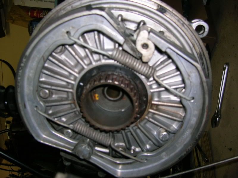

Re: rear brakes
« Reply #1 on: March 23, 2009, 10:46:55 AM »
The lower shoe looks like it's not installed right.  Can you post a pic showing both pivots at once?  I thought the shoes had different ends.

« Reply #3 on: March 23, 2009, 11:57:23 PM »
Here is a pic of my rear brake shoes installed - one thing I noticed is that one can end up with the ends of the shoes that pivot on the common "bolt" (toward left/bottom of pic) a bit misaligned in which they don't properly pivot and might  either bind up or not travel properly.
IT does look like your cam is a bit worn from the photo, though I don't know if it is too worn.. hmmm.

« Reply #4 on: March 24, 2009, 04:14:34 AM »
Umm - IMHO I think it is time to replace the cam... and I agree with Ed - the ends don't look quite right either.

« Reply #7 on: March 25, 2009, 08:09:00 AM »
The cam should not be able to pass the end of the shoe. It could be the wrong cam if the final drive was replaced, the cam could be worn, or the shoe could be bent (unlikely).  Ordering a new cam would be my first move.

« Reply #8 on: March 25, 2009, 08:50:53 AM »
In the first set of photos,there is a difference in the shoes.
There is a difference in the length of the straight section of metal that contacts the cam, one is significantly longer than the other.
Looking at the installation on the LS, both shoes look to be the same dimension.
I would suspect an incorrect part, or more likely at some point in time some 'adjustment' has been made to the lower shoe.

« Reply #9 on: March 25, 2009, 09:00:09 AM »
I think that Bob may be on to something - perhaps if you could take your shoes off and examine them for part numbers ?   I am thinking that maybe a PO had replaced the bottom shoe with one for an LS (which take a slightly bigger shoe as the rear hub area is slightly larger in diameter).   If the lower shoe end were a bit shorter it might not go past the end of the cam - it's a thought anyhow..   But, the ends of the cam in Darwin's picture do appear to be more worn down than in mine also.

« Reply #10 on: March 25, 2009, 03:47:42 PM »
According to the motobins site posted above, the LS has different shoes than the regular R65s, and the pictures of the regular R65s were like the ones in Darwin's pictures.  I'll be changing tires in a few weeks, but I don't feel like pulling my rear tire for a look until then.  Sorry.  My bike is only a month newer, so I bet I'll have the same brakes as Darwin.

« Reply #11 on: March 25, 2009, 07:22:42 PM »
Those are LS shoes in NHMAF's pic.  [stare and compare] They are positioned correctly [top & bottom are slightly different]

Re: rear brakes
« Reply #12 on: March 25, 2009, 08:35:42 PM »
I guess that I shouldn't have assumed that a pic of mine would help anything !  I do know that the LS shoes are slightly "bigger" due to the differences in the rear wheel (snowflake .vs. LS)  housing diameter, but I thought that the relative sizes from top/bottom where the same as compared to the snowflake wheels, but that is my bad, I guess.

« Reply #14 on: March 26, 2009, 09:19:42 AM »
Compared to Rob's pics, the ends of the shoes on Darwin's bike don't seem to be in the right place?   Maybe they are the wrong ones, or that cam is really worn down?
