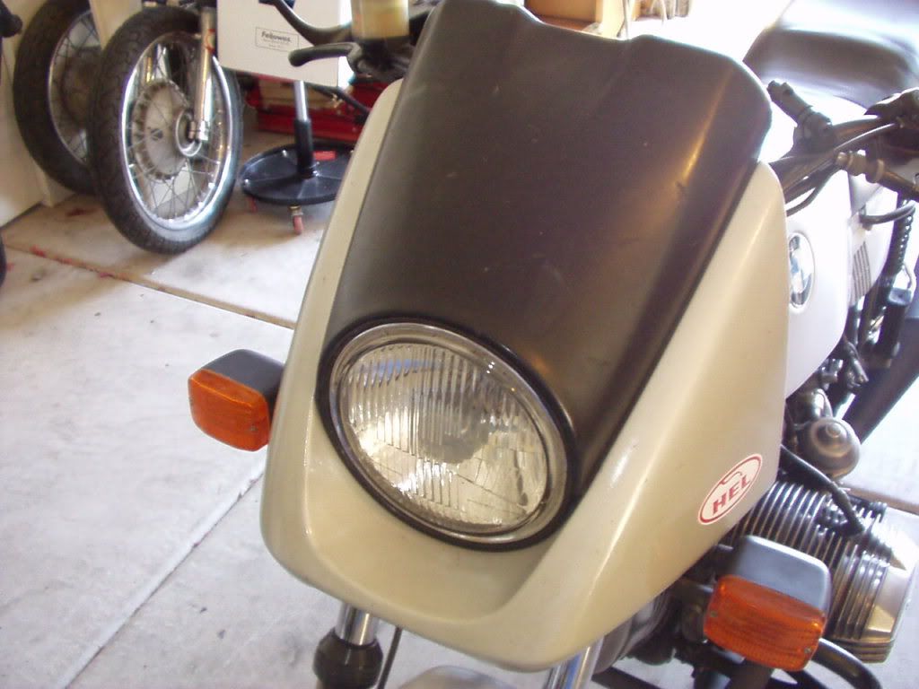

Re: naked or small fairing on R65LS?
« Reply #10 on: April 18, 2009, 06:01:57 PM »
Ok, there are some pictures up on http://s101.photobucket.com/albums/m70/mrridden/ of the Hillbilly Speed Plow fix. Background is; when I got this bike there was no front faring at all. Just a sawed off top cover with the gauges nekked to God and everyone. A post on BMWOA and an exchange of one Ulysses S. Grant got me a dinged up plow and top cover with all the tabs broken. Bondo smoothed out the dog chew and storage with a cheese grater marks on the lower. Some 2" wide Velcro was JB Welded on to the back of the upper and lower [be careful to align so they match] and a 2"X4" strap of the fuzzy velcro holds the two together. With the ignition switch nut, Velcro and rubber headlamp shell gasket holding everything together I don't get any flapping, buzzing or other complaints. Bonus, the top shell comes off faster than with the original Snap, break and swear setup. Push down on the top shell when putting the Velcro backing on to make a snug fit. Now can anyone carbon fiber my top shell? I think it would look good.
« Reply #11 on: April 18, 2009, 08:03:08 PM »
Thanks, Rich !!!

TheLSKid
« Reply #12 on: April 19, 2009, 12:17:13 AM »
 Thanks. Great fix!
plc
« Reply #13 on: April 19, 2009, 04:20:35 AM »
Rich,
Thanks for that, awesome fix. Now no longer concerned about those two little clips coming off.
Paul
