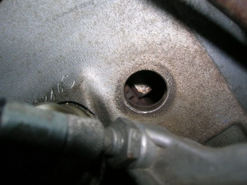

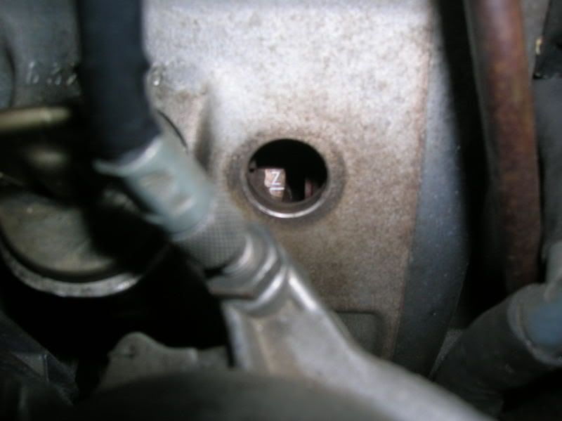

So FWIW, here is my "Z" timing mark for full advance:
And with the bike in 2nd gear, spark plugs out, I roll the bike ahead
about 1 inch and I see the "S" mark.
You notice the "S" is at the "bottom" of a metal tab, or protrusion, on the starter ring on the flywheel.  Just above the "S" in the shadow of the hold is the "OT" mark on that same metal tab, about 1/4" above the "S".  I don't have a good pic of it as my batteries died trying to get a decent pic of it.   IF would say that if you find your "OT" mark, look carefully below it to see if you don't see a faint "S" in the rust..
