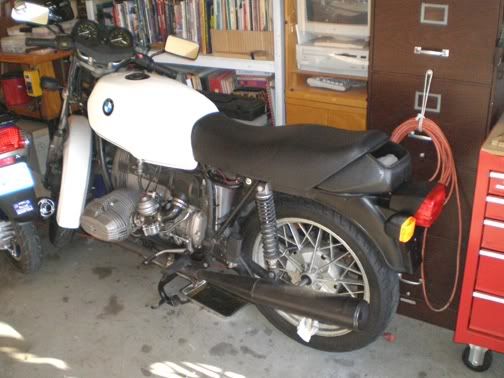

Before... with the lovely two-toned Lucha Libre styled seat. And what's up with that lame white paint? Gag me!
After... Oy Vey! So much more BMW classic. The side panels and seat tail are already prepped for a BMW blue. Tank and fender shortly.

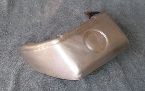

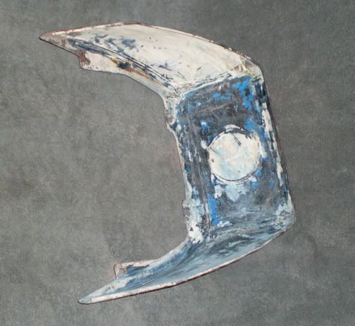

What a mess! Bent metal. Multiple coats of paint, including...dayglo ORANGE! I'm getting there...

This was under the white????  :o
Re: R65 Seat Cover Replacement
« Reply #2 on: March 18, 2009, 06:46:50 PM »
Yep! I had already removed the dayglo orange that was on the left side, IIRC, only on the tail piece. I dunno...
The original BMW color code on the bike says 501. That's a metallic blue. And so she will be.
From the above, to straightened metal, to...
...primer.

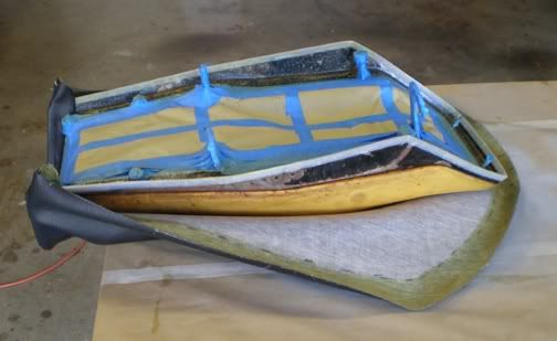

 Â    Clean off all previous upholstery adhesive. You need a solid foundation for your work. Big box home stores carry an excellent glue removal product, Motsenbocker’s Lift Off.
 Â   One of the R65 group mentioned that he was experimenting with some small, nylon U-channel that was originally used to protect band saw blades. He sent me some. This channel fit the seat pan edge exceptionally well, required no bonding and protects  the new seat cover from cuts where the material wraps over the semi-sharp edge.
 Â   I favor 3M Super Trim Adhesive. It has the highest bond strength available in a rattle can. Shoot three full coats of adhesive onto the pan and the fabric.
Seat masked, adhesive sprayed on pan and cover. Note plastic U-channel on seat pan edge.
 Â  The cover's instruction page suggested a hair dryer or a heat gun to make the vinyl easier to stretch and fit. Forget about using your significant other’s hair dryer. It won’t generate enough heat to get the job done. A true heat gun is what you need to stretch and draw down the vinyl to where a Marine D.I. could bounce a quarter off of it.

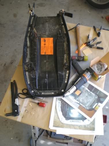

Just about finished. Tools req'd shown.
