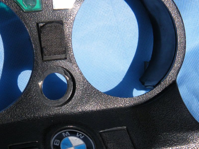

Well, the previous owner (and me a little bit before I figured out how to take it off) must have got  a little crazy on the spedometer dashboard trim piece as it did finally pull apart as shown in the photo below.
A fancy glue or epoxy, metal strap with screws, combo of both?
Surely someone has had this problem before and fixed it?
Update, looking on the A&S microfiche, it looks like this is called the hub cap upper  32 71 1 236 896.  Google searching for "r65 hub cap upper  32 71 1 236 896" brings me to http://www.bobsbmw.com/catalog/2003_catalog/Air-Head_Parts.pdf which lists the part for about $68 which I would consider a deal in lieu of pocket screwing/gluing.  They call it a HANDLEBAR DASHBOARD (or “Impact Plate�).  My only hesitation is I see no part number on the original piece.  I suppose I should take the plunge and buy a new piece.  Thoughts?

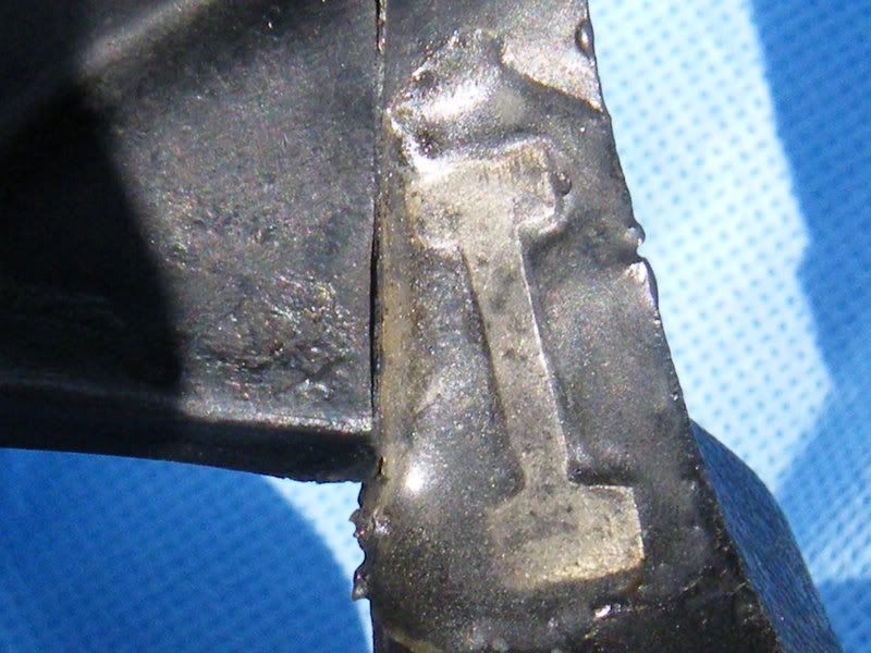

No problemo Bill.
I fixed my dash 18 months ago, using a 1.2 mm strip of mild steel cut into an 'I ' section. I heated the strip with a blow torch and laid it across the fracture in the plastic, on the underside (with the fracture held together) so that it burned a nice deep slot for itself (sunk about 2mm down). Cooled the strip then epoxy glued it into position. This has produced an extremely tough and essentially, invisible repair. Good luck.

As the Guinness guy would say, "Brilliant".  Thanks from over the pond.
Re: Any ideas how to fix cracked handlebar dashboard?
« Reply #3 on: March 07, 2009, 07:06:59 AM »
That was great, Lars. Truly innovative/creative idea.  And it looks perfect.
