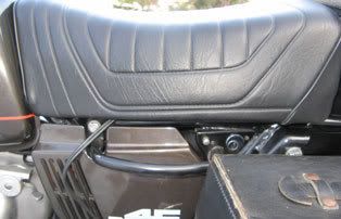

seat when secure, you have to remove the pannier to access the key hole:

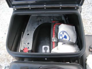

underside of seat.  rear attach point looks stock, front one doesn't, and again, gotta remove the other pannier to open it this far:
close-up of front attach point:

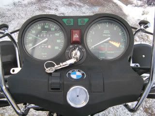

the dash.  Yup, have flashers.  The silver circle thing on the bottom is for a clock.  Battery died and I haven't yet replaced it.  The speedo is in Km, and you have to turn the key all the way to the right to turn on the lights.  Or you can run around with the lights off.  Best remember to put the stand up before you drive off too, because it won't kill the engine if you drop it into gear with it down.

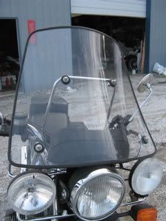

close up of the wind screen.  Very retro and slightly archaic looking compared to the new stuff.  hehehe

That front seat hinge mount looks like it is a modified front sub-frame bolt...
I'm not sure I like that, considering how much stress in on that fastener.
The rear mount looks stock, as you say, but I think it is further forward than the two-seaters.
Here is a picture that shows the location of my rear seat hinge mount:

And I will have to go out to the garage to be sure, but I think your rear hinge may pivot on the pivot for the front hinge on the two-seater.

Here is a picture I found on my hard drive.  It appears to confirm my suspicions that your bike is using the front dual seat hinge pin for your rear.  This leaves me with a new possibility!  A hinged seat!  Finding one of those front hinges will be another thing.
