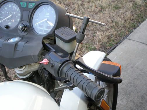

For $22.99, I bought a pair of black, rectangular, all metal, short stem, Universal Japanese Motorcycle mirrors. Modifying the R65's mirror perch required tapping the mounting holes to 10mmx1.25. That was the sum total effort required to adapt the Beemer to accept mirrors designed for any Suzuhondasaki. Yamaha has right and left hand threaded mirror mounts so be forewarned... avoid those.
11/32" drill and a 10mmx1.25 metric tap preps the R65 mirror mount hole. Cake. The '81 is next.
Was necessary to remove the front brake hydraulic fluid reservoir cap to thread on the right-hand mirror stalk. It's close.
So much nicer. These mirrors are Whitney item number 011158 and are an EMGO product. I tucked a 14mm OE wrench in my pocket and went for a ride. Stopped a few times to get the mirrors positioned to my tastes. Lock nuts at the perch and mirror swivel point.
