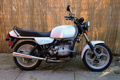

these badboys are standard in North America (Canada in my case) US bars
I just took them off, I can measure them if you want.
I found this photo of a stock R65 mono from a UK site before a resto and these must be the Euro Spec bar

Mr. Chopper.
Took some pics and measurements.
Check it out here on my Picassa.
http://picasaweb.google.com/veryscarygary/R65USBars?feat=directlink
Here's how they fit when I had them on.
« Last Edit: January 16, 2009, 06:57:06 PM by scarygary »
