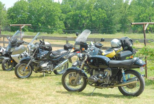

Tech day was definitely out in the country. My ride up and back was through fields of wild flowers and bright green trees. Spring done Sprung. My R100S got quite a bit of photo attention. Gosh. Note the new BMW scooter peeking out the left end of the bike line.

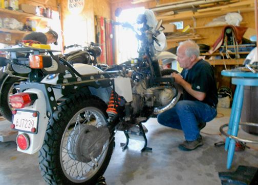

Texas Air Marshall Mike Moon assists with the install of a new ND starter replacing the much heavier Bosch unit in this well used R80PD.

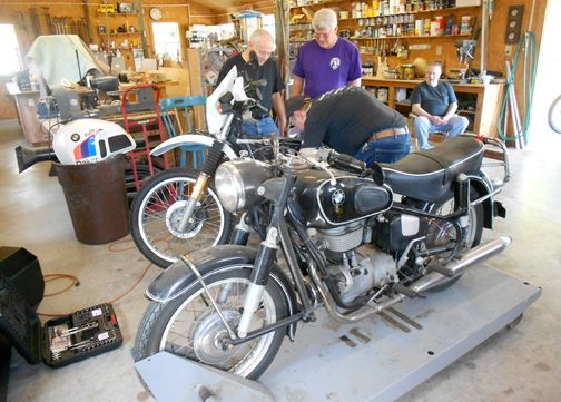

The R-One Lunger is also owned by the PD gentleman. It was scheduled for some driveline work. Huge pneumatic bike lift was impressive.
