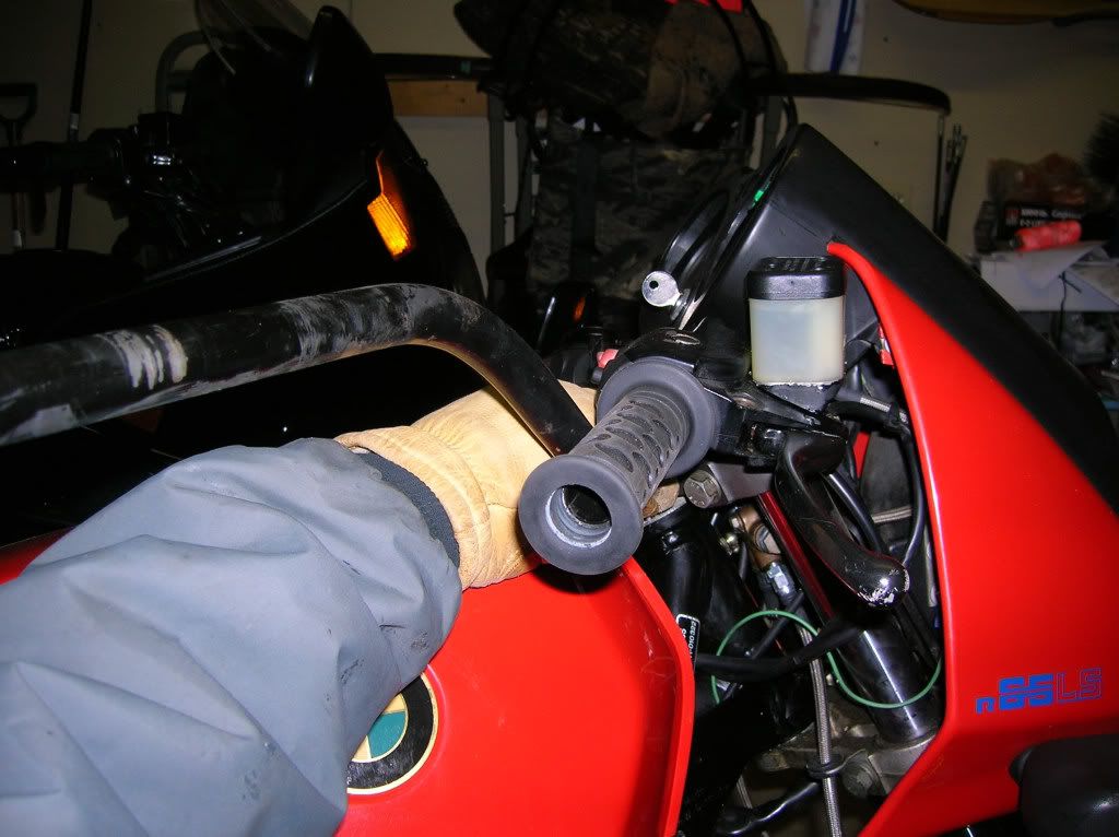

Re: R65LS handle bars
« Reply #8 on: November 24, 2008, 04:16:58 PM »
I have the low European bars and didn't feel comfortable with them.  I rotated them in the clamps which brought them back towards me by 1 inch or so  but now they pointed down so I wasn't really any better off.
I decided to try and bend them - just a little.   I could make no impression on them cold.
I heated the bends gently with a blow lamp and manged to move them (Steel starts to weaken at quite low temperatures).  Finished up with the bar ends about 1 inch further back and 1 inch higher than stock.
It doesn't sound much but I can feel the difference and I swear the bike is easier to balance when moving it around in the garage.  A slight bluing of the chrome polished ok.

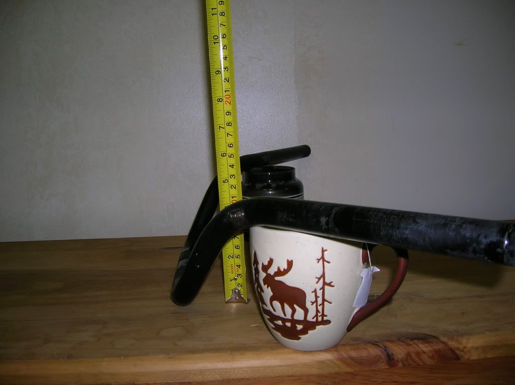

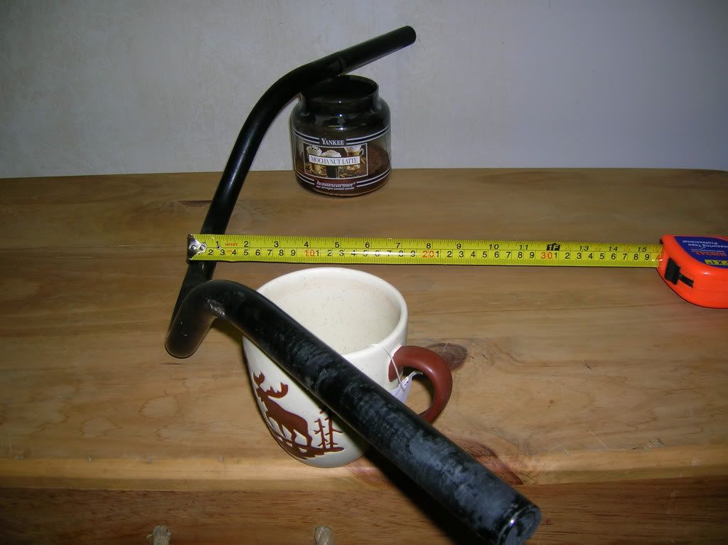

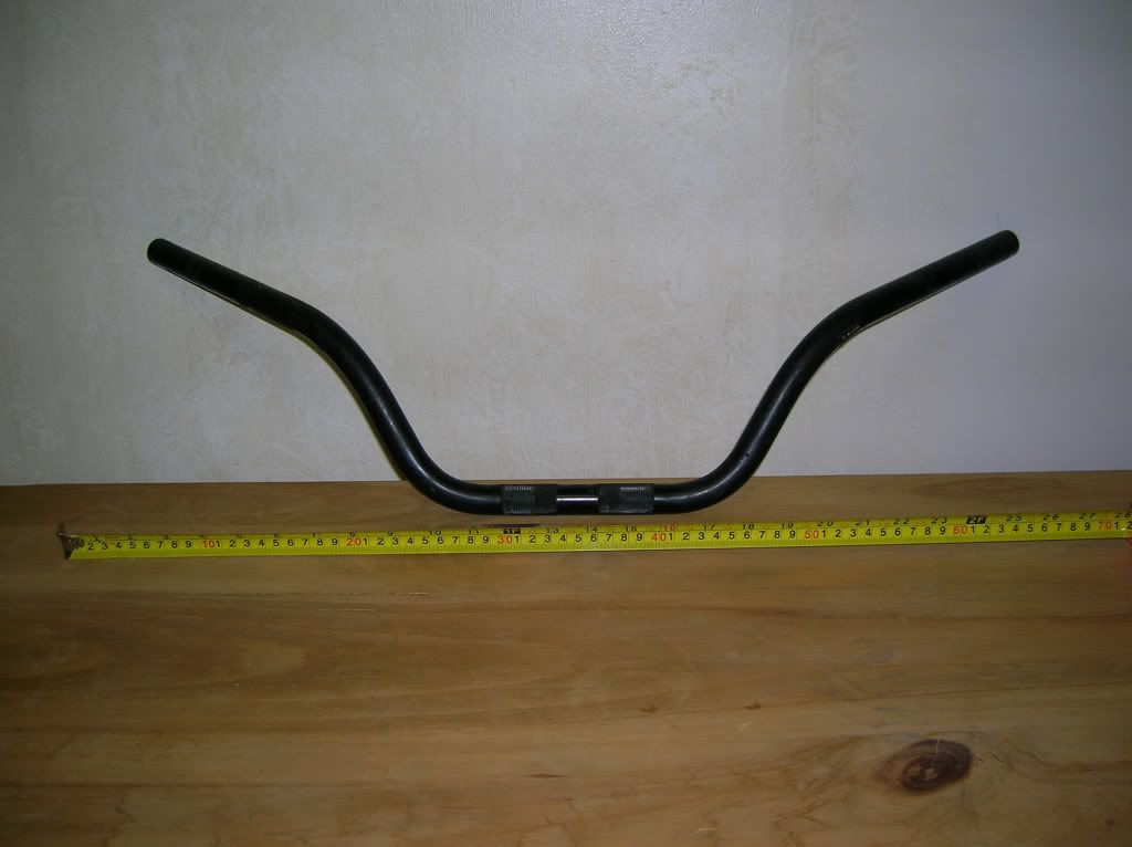

« Reply #9 on: November 24, 2008, 10:44:33 PM »
I found some old photos that I had taken for Kling Tut - if you look for a set of USA high bars for your LS, this should give you some idea of the difference.
I didn't like them on my LS as they didn't look quite right to me, plus I am fairly tall, and the bars had so much pullback and were so relatively wide I felt like I basically had my hands almost in my pants pockets when grabbing the bar grips, and I was forced to sit straight up and couldn't lean forward into the wind.   My arms are long enough (sleeve length on my dress shirts is 34/35) that reaching the lower bars is no problem and doesn't have me leaning forward all that much.
I even used my dual English/Metric unit tape measure at the time for the metrically challenged   ;)

« Reply #10 on: November 24, 2008, 11:55:21 PM »
Great pictures, nhmaf!
Yeah, Kling-Tut, up in Chicago.  Mostly into GL-type Hondas.
I, too, really like the low bars.  I feel like I am more "at one" with the bike.
Someone pointed to this site earlier? Motorworks
 (UK)
It says the /5 R65 bar is only a 50mm rise versus
/6 /7 R90S/CS with a 75mm rise!
