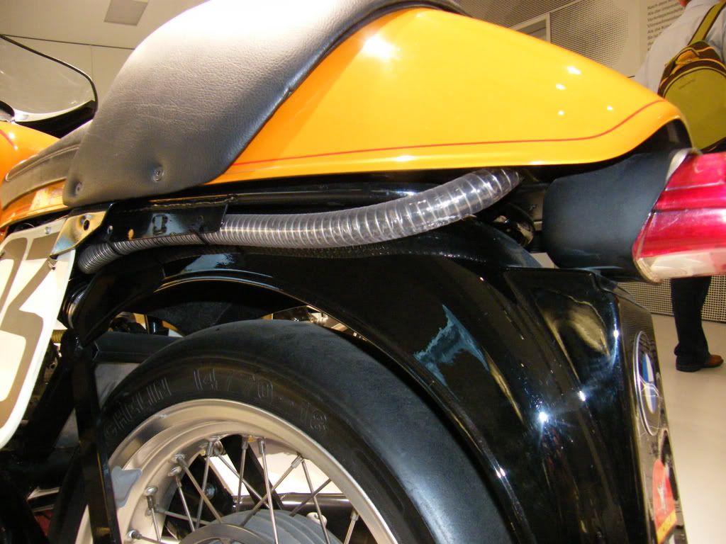

I can't answer your question, but, you might like to see this pic of a completely racerised R90s in the BMW museum. The crankcase breather is fed into the 'tail box' to prevent any oil escaping onto track or rear tyres etc. Unfortunately my mind wasn't really on the job when I took the pic and I didn't find out wether it was a collection bottle or filter the pipe was breathing into. But, I'm sure BMW museum would let us know if we asked nicely.
