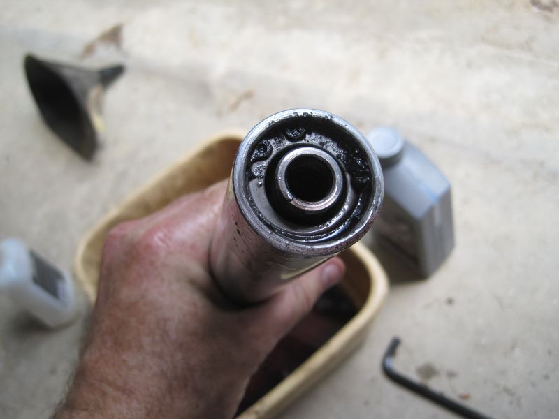

Generally speaking, if you remove the sliders/lowers from the fork as part of replacing a leaking fork seal, just slide out the damper rod assembly base from the end of the fork tube and look for the telltale black "gunk" of plastic bits that signifies a disintegrated black plastic topping out bumper/bush inside the damper assembly within the fork tube:
Ugh!

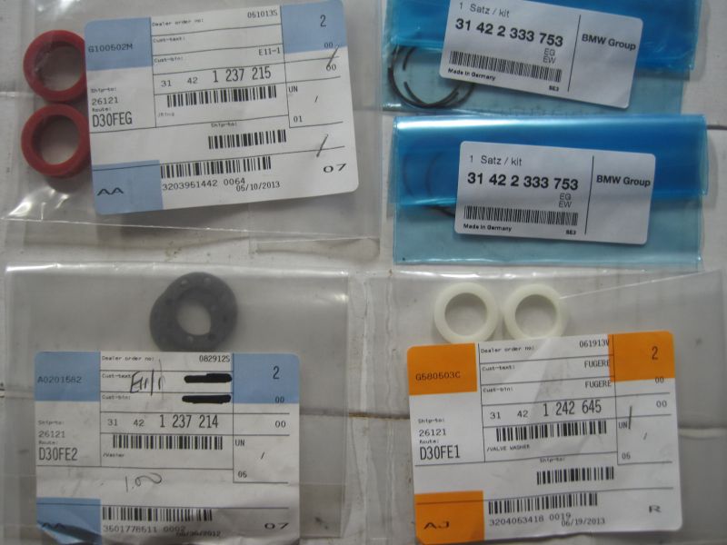

OK, these are the parts you will need (or at least can buy, as some are No longer available) for rebuilding the damper rod assembly:
*IF* you are careful when removing the damper rod assembly, you *may* not need to get new wiper rings for the damper rod piston (those tiny piston ring things in the upper right corner of the picture) as they usually don't wear out, but can become damaged, bent, mangled, etc. upon either removal or re-installation, or if you've just been unlucky.   These are the most expensive parts of the rebuild list - they are almost $8 a piece and you need (3) for each piston (one in each fork tube)

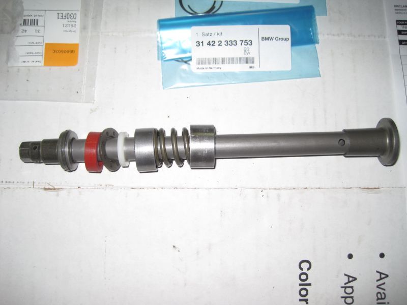

This is what the re-assembled damper piston assembly would like like with replacement topping out bumper (red plastic ring which replaces the previously missing/disintegrated black platic ring in the first pic in this thread). and new valve washer (white plastic ring) and drilled washer (metal disk with 8 drilled holes in its outer edge).   I was fortunate and could re-use my original piston rings, though I did carefull clean everything and inspect for damage prior to assembly.
The "official" writeup will include more info, plus tips on how to get the $%^&@! thing back into its tube and compressing that @#$% spring!
