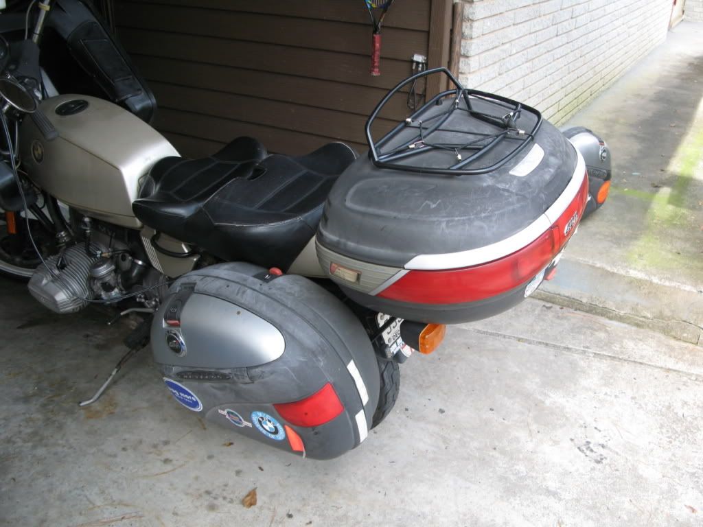

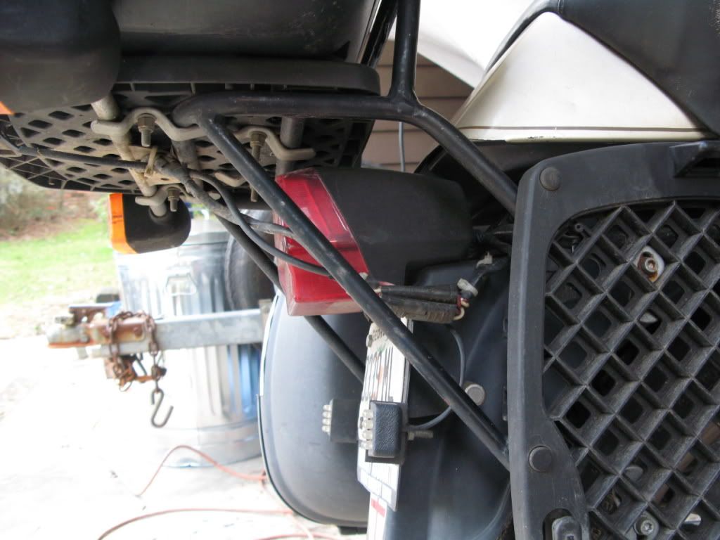

Hi SincityR65,
I started with a Givi E46 top-case and then went with the E52.  I attached it with a Givi universal plate to the Krauser Luggage rack on my R65.
With these top-cases on you will need to re-inforce the rack assembly.  I welded two bars from the back of Krauser rack to the back end of the short luggage rack.  This creates a rigid triangle.  Also I had some of the welds brazed when they cracked.  Since this has been done I have had no problems.
If you get the Givi - or any top-case - DO NOT MISS THIS OPPORTUNITY TO ADD ANOTHER BRAKE LIGHT.  The Givi top cases have this option.  You cannot put a price on this extremely important safety item.  Get the built in brake light!!!!!!!!!!!!!!!!  I'll post picks of my modified rack when I get home Sunday.

« Reply #8 on: January 28, 2010, 12:07:33 PM »
I forgot I was supposed to post these pictures.  For the record I have the one piece Krauser Rack Assembly.  It has be reinforced at most of the joints with brazing and extra bars have been added to support the top case.
I used the Givi Universal plates to attach the E52 topcase and the panniers.
