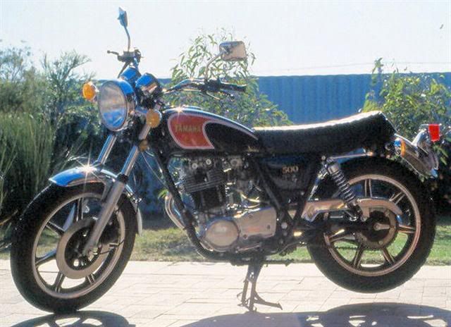

Ah, yes, my SR500 was much beloved and only sold because my (now ex) wife thought a bike and VW Beetle were too much. Now realise which one I should have parted with instead!!!!
My new wife has no problems with me having a car and three bikes (though I'd better not push it!! LOL).
Here's a pic of my new (then) '79 SR500, loved it as much as I do my Airheads.
Bill......................;-)

Airhead, that SR is beautiful. You should get another. Good web forum for them now, with a couple of WA (Western Australia, not Washingtonboys in there).
