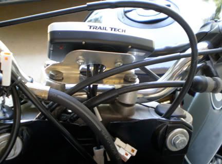

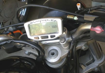

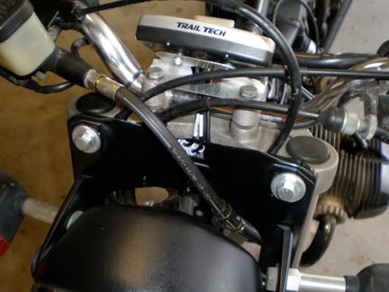

... as for the routing i was wondering more on how the cable is routed through the dash and forks as the routing i had on the previous cable seemed very tight and congested.
If that's the case, then you had the correct cable routing. Before removing the steam gauges and cluster housing for a digital gauge, I was always bummed about the cables bending the plastic housing and their 'bendy' routing. After dumping the pod, cables are much happier, as am I.
Pics may be helpful.
