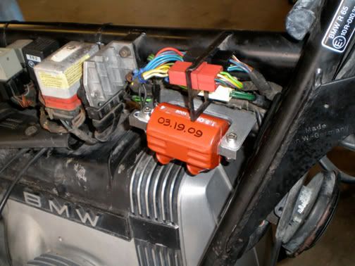

Many of us here in the USofA buy our Dyna coils from Rick Jones' Motorrad Elektrik. http://www.motoelekt.com/ They come with a nice aluminum mounting bracket and the needed hardware. The bracket has an L-shaped flange that bolts to the OEM coil mount. The photo explains the rest. Don't cheap out on a thin piece of bent metal; the vertical up n' down motion of the bike might crack something thin.
