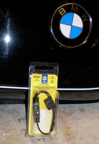

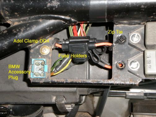

Or you can keep to the KISS principle as did I.
Stop by your local NAPA store and pick up two of these waterproof, mini-blade fuse holders. Get a couple 7.5amp mini fuses while you're there.
Wire the fuse holders directly into the harness and call it done.
To paraphrase one of our famous forum members, "Lighter. Faster."

« Reply #6 on: February 02, 2015, 08:49:31 AM »
When I was making some changes to the wiring on my bike I followed Monte's lead and put the same type of fuse holder and fuses in place. Now when I have an electrical issue I only have 1000 possible culprits instead of 1001.   ;D
