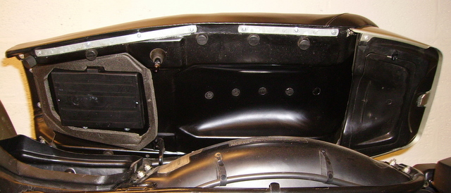

The rubber bump at the locking pin of my seat is badly worn.
At this point I've big trouble opening the seat as it locks too deep.
My dealer told me it is unobtainium...
So, fellows R65 users, any idea for a replacement ? A fix ?
Thanks for my R65 and my butt....

Start your search at the local hardware store. Look for tapered rubber bunghole plugs. Some may have threaded shanks on the larger o.d. end.

I'm at work right now, so I can't look at a seat .
Is the rubber bumper held in with a screw going through the center ?
I'll just throw this out there, home winemaking and brewing shops have drilled tapered rubber stoppers, don't know if it will work in this application or not .

The bumper has a hole in its centre. It is fitted on the pin of the seat which serve to lock the seat on the lock.
I think it is used to limit the travel of the pin into the lock as it is serrated between the seat and the lock box on the frame.
I will look at rubber blocks used in wine making...

Do you have all of the other 10 rubber stops in place around the seat edge. They are intended to support the seat not just the locking pin.

I think the rubbers and the hinges are available at Motobins and Motorworks.

There's a rubber bump stop an ebay in the US, it's still not cheap but I don't know what the dealer wanted to charge you.
