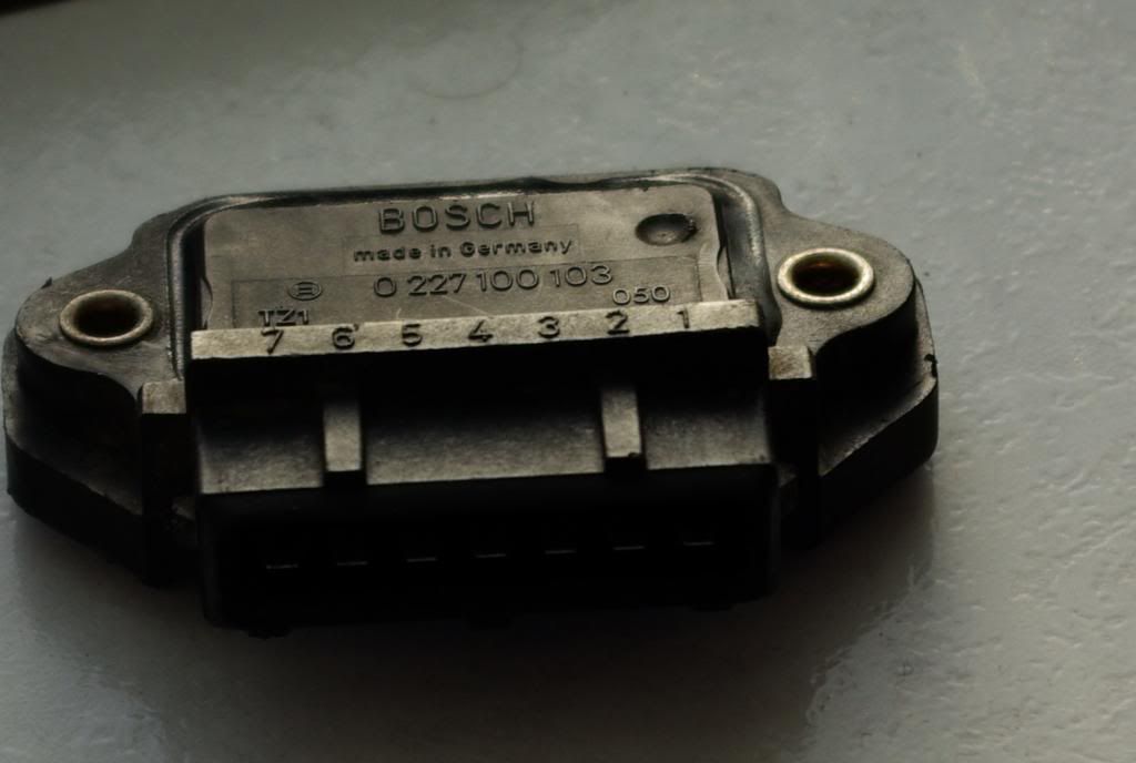

When you replaced the ignition control module under the tank, did you apply heat-sink compound to the mating surface between the module and the aluminum heat-sink ?
Or was yours one of the module bonded to the heat-sink type ?

Thanks Bob.
This is CDI unit that was replaced. The local Bike shop did the work in this instance as I couldn't work out the problem. The guy that owns Caringbah Motor Cycles seems to know what he is doing.
