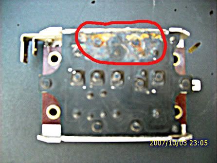

The discoloration you see on the diode board might be simply some corrosion, or could be the result of overheating.  Things do get pretty hot there anyways, but if a diode has gone bad usually the back metal surface (the 2nd photo) will show a little "bronze" coloring of the normally silvery diode backing.  We probably ought not to try to get into testing the individual diodes, but here is some more info for you.
BMW did issue a service bulletin for pre-81 bikes on Sept, 1988 (#12-012-99 (2323) according to my Clymer manual) for warranty replacement of the diode board if the
model had a black electrostatic dip paint finish on the timing cover.  The symptoms identified were melted solder joints on the board, low battery charge rate and/or partially glowing GEN light.   But, we may as well check that perhaps we can "fix" the problem (if it isn't bad solder joints and is simply bad grounding at the diode board) by cleaning up any corrosion that you see on all the mounting/grounding points and tabs where the wire plug onto the diode board.   Check that all wires that plug into the board are not pinched/kinked or have worn-through insulation, loose fitting contacts etc.   Clean all these contacts with some emery cloth or electronics contact cleaner and an old toothbrush.   Make sure things are dry before you reconnect and try to fire the ol bike up.

If you still aren't getting proper charging voltage, there is either a bad wire connection somewhere or the diode board is indeed in need of replacing, I think.  It seems
that we'd already eliminated the voltage regulator from the list of problem suspects, and we know that your GEN light bulb is working...   others may have other opinions/input to help you out..

Some of the wires coming out of the engine case that plug into the diode board were pretty chewed up.  How do I replace these?  Do I have to (gulp) crack the engine??
I tried picking at the obviously corroded wire heads on the diode board and female receivers coming from the engine with a set of those sharp pointy pics that look like they belong in the dentist's office.  I thought that would do it but maybe not.  I will try with the emory board and electrical cleaner.  I think I lost my metal toothbrushes when I moved.
Also, some of the wires on outside of the alternator itself were pretty chewed up.  How do I replace them?  Just tear and re-soder?  Is it that brute??

Do you think the wires are actually bad enough to be shorting out?  I wonder what chewed them up.  If I remember right, the other (engine) side of the diode board is under the starter cover, which is held on by only two bolts.  You can remove that and see the inner side of those wires.  That's not the inside of the engine, which would be a very bad place for wires.  Replacing them would probably be a pain though.
Re: '79 R65 Dies at Idle
« Reply #34 on: September 07, 2008, 12:54:20 PM »
If you choose to remove the front engine/starter cover, BE SURE TO DETACH THE NEGATIVE BATTERY CABLE FIRST! A misstep with a wrench or screwdriver can generate lightning bolts.  :'(
