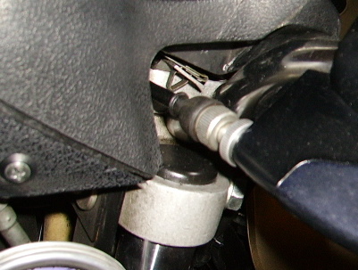

Ever since I swapped my U.S standard handle bars with the shorter euro spec ones, I'm having troubles with my Brake line hitting the bottom of the tachometer, awkwardly pushing the whole right assembly into the rubber instrument cover. Same goes for the Left side controls. except its the clutch cable pushing it up this time.
I kinda wasted my entire afternoon routing and re-routing before I thought that I'm doing something wrong.
By any chance does anyone has a picture or can show me how the control assemblies are properly routed?

I have the low bars and things are tight. For example to remove the instrument surround I have to slacken off and rotate the right hand controls a little. Nothing touches in use though.
I'm decorating and up to the eyes in emulsion paint at the moment. Just taking a well earned break and a cup of coffee. If I get a chance later on when I'm finished I'll take some pics for you.
Here's a picture of the left side I posted some years back.
Re: Control Assembly and cable routing
« Reply #4 on: January 09, 2015, 02:36:46 PM »
Here's a picture of the RH side although I'm not sure how much it's going to help.

And that's exactly what I needed to see Barry. The right hand side fitted in properly with still some room to spare. Thanks.
Btw, is that the earlier round master cylinder?
Julio Alarcon
1981 R65
1976 R90/6
2001 R1150 GS/ADV
2015 TR650
« Reply #6 on: January 10, 2015, 04:07:56 AM »
Yes it is.
