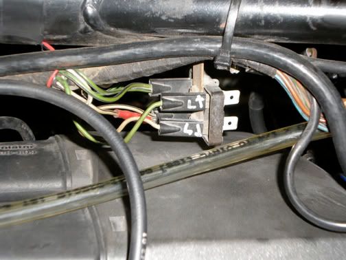

I was riding home today and again wiring troubles started. I lost the turn signals, then I noticed that the brake lights were gone as well. The headlight was still there so I could drive back to home.
Intermittent as I said. The thing was that the electrics came back and went away again only in 2 seconds. I decided that this time I will not give up. Instead of trying to chase that demon, I started to shake every connection one by one to see when do I get the electrics back. Voila - in half an hour I had found the source:
The fault was under the tank in the back end. Somebody has put a extensions over there so you could unplug the wires for some reason. I checked these wires and the green with black stripe sources pretty much everything: starting from horn, turn signals and brake lights to headlight itself. So that is the bugger which left me by the side of the road once.
Do not take notice into the upgraded intake manifold. The old one was too slow for me and I had to dump it to give room to this beauty. 2,5bhp more!
Re: Wiring errors
« Reply #7 on: July 10, 2014, 10:36:43 PM »
Those wires should go to the fuse box, but yours is missing.  The blue wires are jumpers put in place of the old fuses.  The box would be held to the backbone of the frame with a hose clamp if it was there.
Go figure... it's usually the ceramic fuses that cause people grief... not the lack of them.
If you want to return to a fused system, might as well go with in-line blade fuses unless you plan on bringing the bike to Pebble Beach.  They'd deduct a few points for the high flow manifold though  :D

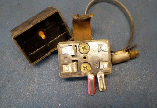

« Reply #8 on: July 11, 2014, 09:45:43 AM »
This is the OEM fuse box location, sans the plastic cover. A semi-constant PITA.
Prone to be troublesome due to corrosion, the euro-style ceramic fuses and their wimpy spring-tension holders are easily upgraded to more modern weather-proof fuse holders and the use of the mini blade fuses.
Probably not a NAPA store in Estonis but there's bound to be a decent auto parts shop where you can locate similar fuse holders. usually two sizes offered; a large fuse holder and the mini-fuse. Get the small ones. Lighter is faster.
I used a small, rubber-cushioned, aluminum DG4 Adel clamp (left) and a zip tie (right) to secure the new fuse holders. Use nothing more than a 7 amp fuse.
