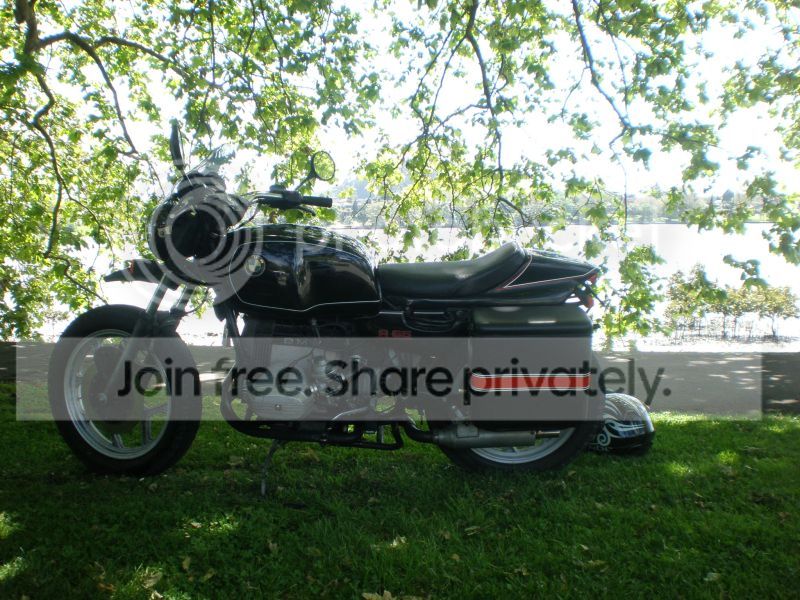

geno05
Re: Bags 86 r65
« Reply #7 on: February 08, 2013, 04:22:00 PM »
Got Hepco and Becker mounts and bags last year from Bob's BMW in Maryland.  They had the indent for the BMW logos, which they also sell.  Everything fit perfect.
See pix on my '86
CaptainSlow
Re: Bags 86 r65
« Reply #8 on: February 12, 2013, 02:56:35 AM »
See pix on my '86
Sorry to hijack this a bit, but I've just bought a set of panniers like these along with the frames. They're from an '81 R100 - as someone stated elsewhere on here that all airhead frames are the same I'm hoping they'll fit my R65LS ????! Can anyone confirm that please? Thanks
Re: Bags 86 r65
« Reply #9 on: February 12, 2013, 08:37:08 AM »
"...all airhead frames are the same," may be a pretty broad, blanket statement. Might need to add a modifier to that statement regarding the different subframe on the SWB R65 and R80.
Your 'new' frames may need some mods to fit. Probably a doable project.
