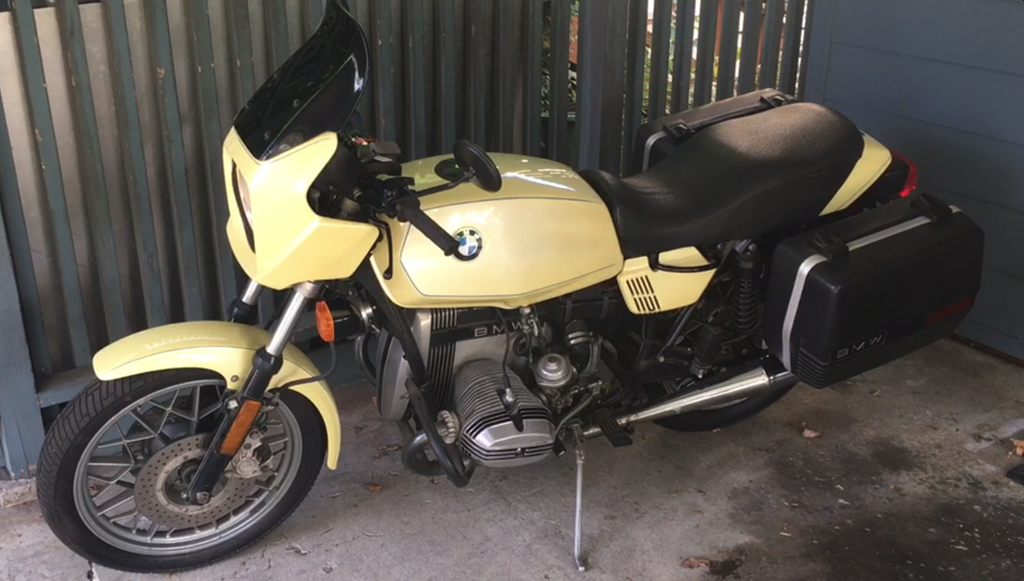

Here's a pic from before she sat for a while... she's dustier and grubbier and a bit in need of TLC and a good bath but in largely the same shape right now. Are those euro bars the PO put on?

Nice colour  :)

Thanks! Honestly, it was neither my doing nor preference but the price was right. I'd prefer something more lemon or banana or egg yolk to the current sickly canary or ancient faded schoolbus shade, but the pearlescence is nice and someone clearly loved it as it's custom mixed and the hand pinstriping and has touchup cans included in the sale. Stripping the paint would be a darned shame so while I intend to change the colors of the painted bits once the mechanicals are sorted I'm going to leave the paint as-is and just wrap the tank and other bits and so on. Maybe a nice Macaublau if I can, period BMW M 4-wheel color... I like to liken it to a black plum that got a sneezeful of glitter, but the paint will be still there underneath untouched.  Are the bars on there what you had across the pond I take it? I believe I have the original US ones included in the spares box, but I ask to ensure if I replace the brake hoses with stainless ones that they're the right ones.

I like the yellow. Very 'period'. Not the right period, but classy.
