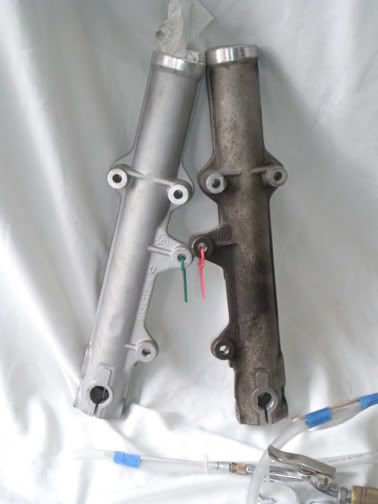

Believe it's in the FAQs section, but there is a DIY baking soda blaster that works quite well on cleaning up stained and grubby alloy. You can see the "gun" btm-right in the photo.
The blaster uses grocery store variety baking soda that dissolves in water, making it ideal for carburetor clean up. Rinse and blow out all those tiny passageways. The idea was actually taken from a foreign car repair shop that had to clean up a brace of carbs off some furrin' vehicle.
Here's what a 50-cent box of soda and ten minutes of time did for the fork lower on my '83 R65.
