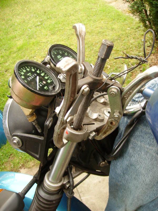

Re: Fork Top Plug Stuck
« Reply #5 on: November 10, 2008, 09:15:04 AM »
I'd leave the hammer in the tool box for this one. maybe put the  fork leg back into the yolks and tighten the bottom one only, lightly snug the top one. This provides a very safe and firm way to hold the stanchion while you're working. Easiest and quickest way to push down the cap is to use an economy gear puller as in picture. While it may require a bit  more time consuming dissasembly of components around the yokes, it gives you complete control of fork springs and makes it very easy to fit n remove the circlip (which can otherwise be a right *****  fiddle). You can work the spring up n down  and have a look at the bore of the stanchions etc and lets hope the cap comes free. Of course the front end of your machine will have been adequately supported now the wheel is out.
P.S. I put a 6mm nut over the pointy tip of the gear puller to protect the threaded cap.
