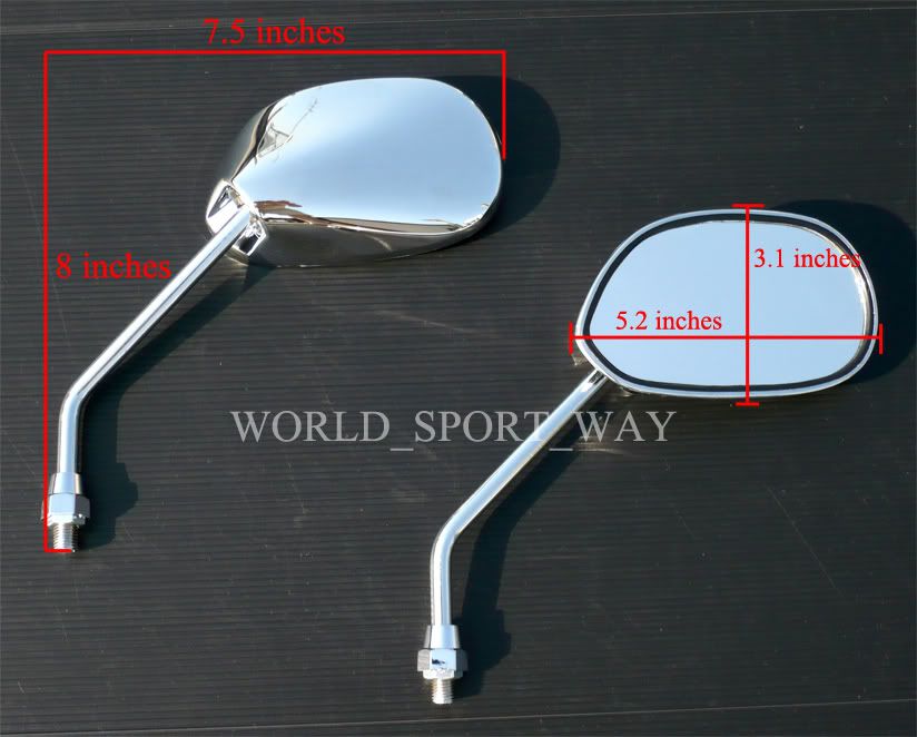

Also what do you all think about these $17 + $13 for ship mirrors?
Re: Boxer Bolshie's '84 Restoration and Rant
« Reply #103 on: March 01, 2012, 06:12:41 PM »
Those mirrors look spiffy but the threads on the mirrors sure look big. Have you confirmed the bling-blings will fit the R65's threaded mirror mounts?
As I recall with my after market mirrors, there is a bit of an interference with the left side switch assembly when attempting to snug down that mirror's locknut -just like the one in your post. BTW, what are those smaller nuts or whatever below the larger chrome nuts?

I was actually thinking the mirrors would have some sort of universal clamp which they would thread onto but I don't know.
