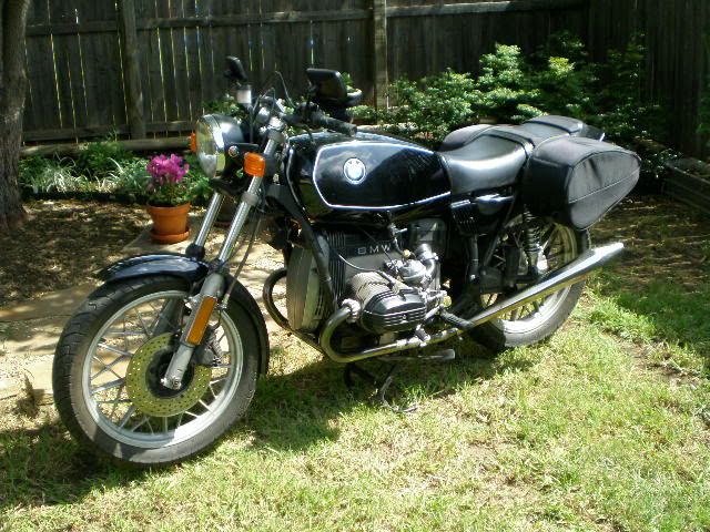

My 1981 in its original, 31-year old black paint with white and red pin striping.

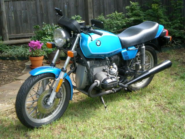

My 1983 repainted in that year's BMW 501 Blau with silber pin striping. Paint code sticker still on rear fender.
