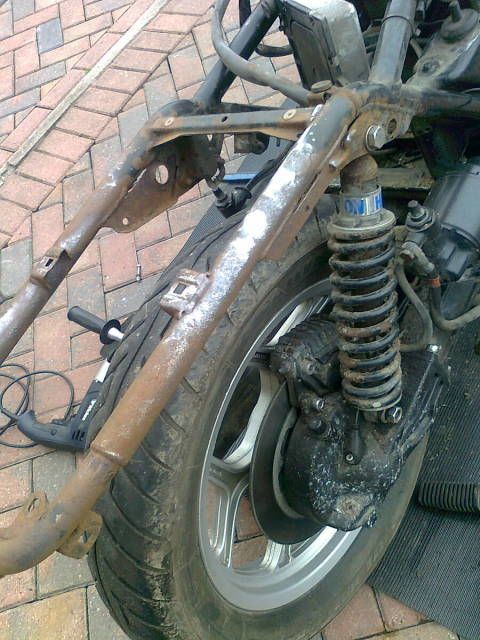

On a happier note i had the K running again today after stripping the back end down to fettle the frame and fit new shock, sorted the fuel leak, just the clip on the return pipe i will put some more pictures up at the weekend.

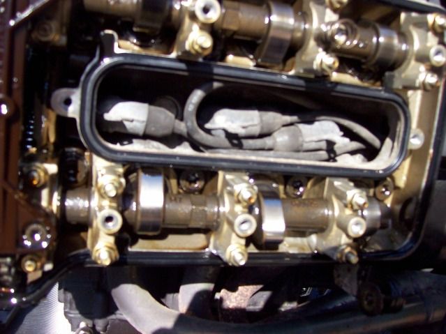

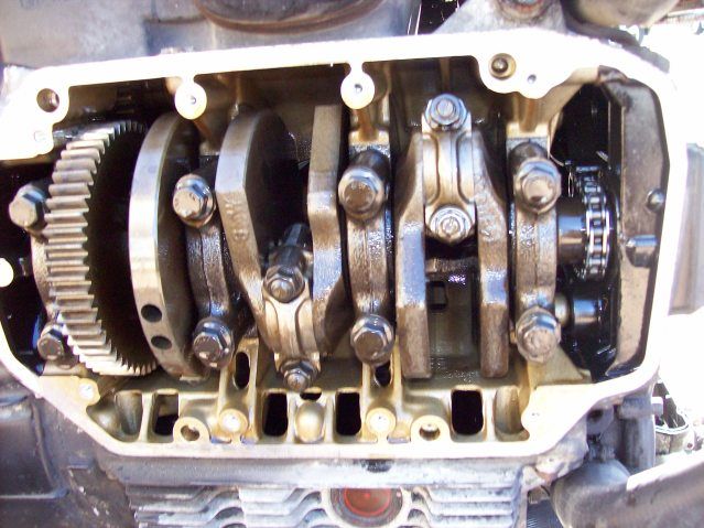

With the fairing off there are a few rough bits on the rear frame
The Engine however when stripped looks like it just came off the production line, the cams look as good as new.

On the camshafts, are those wrenching areas to turn the cam, like for setting valve clearances ?
Re: The K75 more of a Tickle
« Reply #7 on: March 11, 2012, 03:27:54 PM »
Bob the valve clearance is set by shims under the cam followers it can be done without removing the camshaft with the help of a special tool, the engine is turned by rotating the rear wheel in top gear.
The "wrenching" areas are for the removal of the drive sprockets.
I have checked the clearances and no adjustment is needed at the moment.Mechanically there seems to be very little wrong with the bike.
If it's like my Z900 with shims on top of buckets the cam is rotated to open the valve then the special J shaped tool holds the edge of the bucket down while the cam lobe is rotated out of the way. The shim can then be removed.
I bet you very rarely have to do it Lou. I set the clearances up on my Z900 after it was run in and they never moved again after that.
