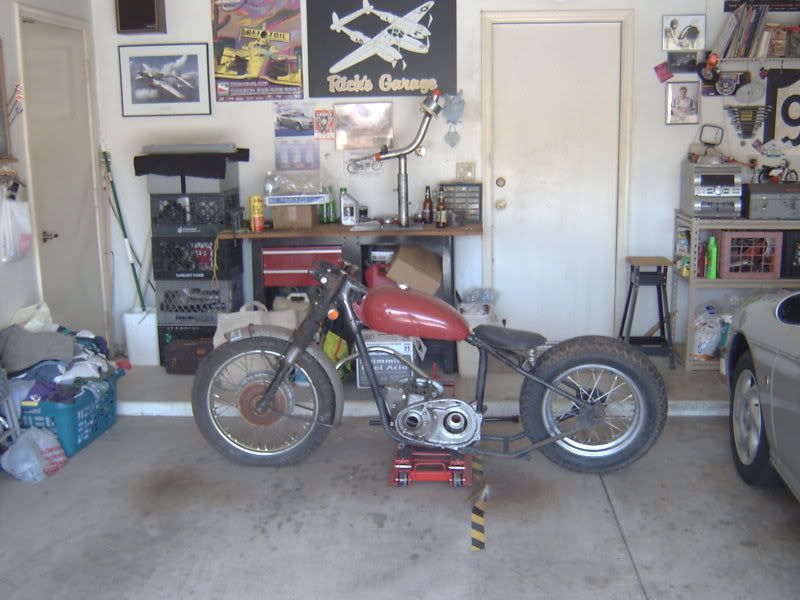

Right hand shift too! I've got one of those old bolt on hard tail frames too. Keep meaning to do something with it.
Re: 71 trump bonnie 650
« Reply #5 on: November 30, 2008, 04:59:53 PM »
Hey Rich that's a "Bobber" with a 1968 or 1969 TLS front brake.  Cool.   When you going to finish it?  8-)
