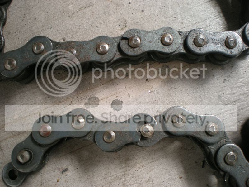

Anyway, this morning I've put it back together with a new master link. I reckon the old one has an interesting story to tell.
There are two failures, although only one caused the chain break (the other probably would have eventually).
The non-critical failure was that the pins were devoid of lubrication, proving that bloody 'O" rings work both ways. When I assembled that chain I smeared grease all over the pins and the holes in the links and then could not get the keeper to seat, eventually I used a chain rivet tool against the flanks of the link to force them together enough to get the keeper on - in the process I reckon I must have wiped all the grease off and then forgotten to replace it. Those pins would have failed eventually from lack of lube.
But what did it in was the pin that  failed just below the groove cut for the keeper. Initially the link didn't break because the still fitted keeper held the outer plate on, but the inner plate would have been flexing ever so slightly it simply gave up just as I was going home last night.
I think I have every right to be pissed-off. I think I'll right to DID and see if they would like to come to the party with a new chain and master-link.

Barry I agree. What peeves more more than a little is that I don't skimp on chains.  Anyway, I've decided it was a random bit of bad luck, it does however point out that the keeper groove is a potential failure point.
Funny thing is I have a tool to peen rivets that I have used exactly once in the 40 years, in fact over the years I have amassed a decent collection of rivet type master-links that I have never used because they are so "in-convenient."
I may rethink that in the light of my failure.

On Friday I untangled the chain and gave it a good clean. After carefully looking at every link I put it back on the bike with a new (and non-DID) master link of the riveted variety.
Whilst doing so I contemplated how long since I last used a riveted master-link and came up with 1979.
Anyway, we did a quick trip to Cape Tribulation for lunch with no chain related problems.
I'll keep a close eye on it however.
