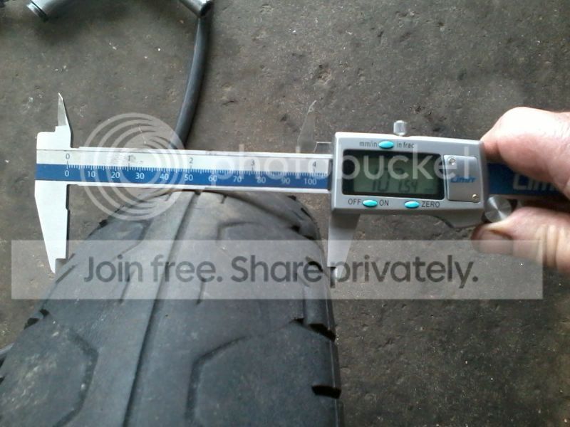

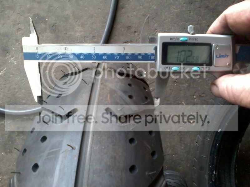

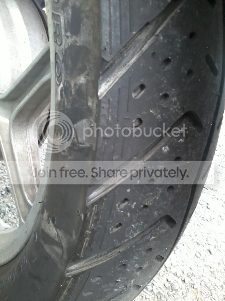

Re: What tyres do others use?
« Reply #13 on: April 22, 2015, 03:02:44 AM »
I got 11,000km out of the Shinko 712, now I'm on 110's. These are a really great tyre, I'm impressed. They call them a Sports Master Pro, the rear seems a flatter profile to the 712, which had huge chicken strips, I can get the 110 rear down to the edge.  The front is rounder, I can get nowhere near the edge....the front is also pretty soft, a thumbnail leaves an impression for several minutes.
Here is the rear - it has numbers 1 to 3 on the edge, no need to measure your chicken strips, the reference numbers are right there.  Virgin tyre on a wet day, so only down to No2 here.
This is the front compared to the 100/90 Spitfire, you can see the dual compound S11 wears nasty later in life, very triangular with the sides worn down, and the harder centre part with more tread.  The S11 is a very wide tyre, I had no problems with it, but the Shinko 110 is a much sharper handling tyre.
