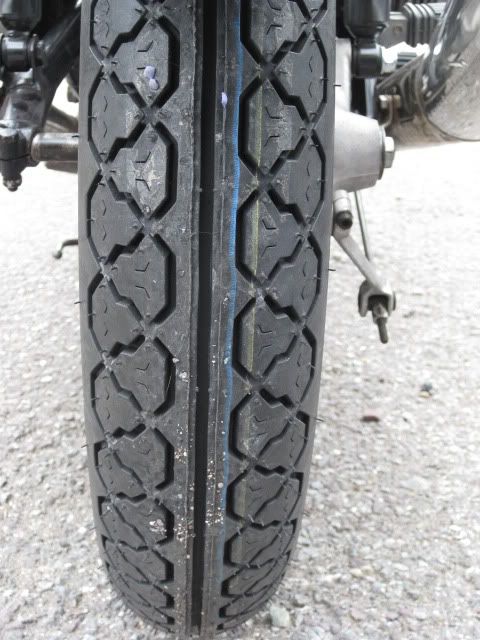

OK, I'm embarrassed to say I have had the bike about 8 weeks now and only finally got around to replace the seriously bald rear tyre yesterday.
I went with the same ME77 4H18 as was on her, Its hard to believe just how much of a difference having a new tyre on the rear makes to the stability on uneven road surfaces.
