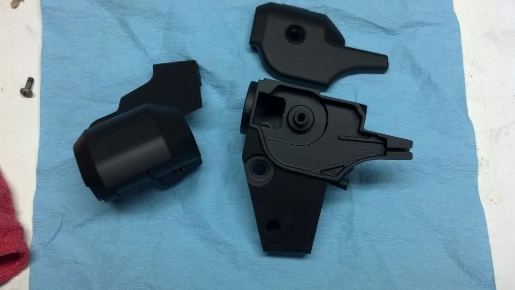

The community workshop "hackerspace" I belong to has the means for powdercoating. I took a short class that demonstrated the process, and yesterday took my control perches in. I stripped them with coal slag in the media blaster, then powder coated them. They came out really nice!

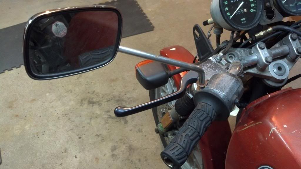

I didn't take any "before" pictures, but here's the same clutch perch on the bike as I bought it:

The gun is charged, and the workpiece is grounded, so the powder is attracted to the work piece. After you coat it, you bake it for 20 minutes and it's done.
I coated the throttle perch, then realized I forgot to mask the threaded holes. Since I hadn't baked the part, I simply blew the powder off it, masked the holes, and re-sprayed.
It's a very cool process, now I'm looking for more parts to treat...   :D
