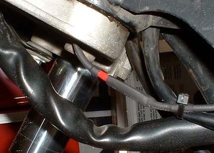

And what did I discover but a clever little LED that I could use to develop an oil pressure warning light that would fit in with my "less is best for my Beemer" project. Plus, it'll get Justin off my case -at least for a few days. ::)
Here's a neat 12 volt LED assembly w/resistor, red lens, a thin lock nut and only $1.99. I added the thin aluminum washer.
Now then. Where can I put this where it will be noticeable as a warning light, safe from harm and not look too tacky? Well, D'Oh! How about that hex-shaped opening there on top of the fork stem? Maybe I could find a replacement nut in all my junk jars that would fit both the LED stem and be a sorta press fit into the stem opening.
Found one! I had to add a thin aluminum washer under the LED to help the fit and finish.
Re-routed the lead from the oil pressure warning switch. It now goes forward rather than back and up into the OE wiring harness. Added a ground wire from the LED to chassis earth. Have insulated spade connectors to ease removal of the LED unit for front end work, if required. Dilectric grease be good.
Hope that sucker never lights up!  [smiley=thumbsup.gif]
