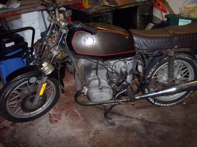

Stupidly picked up this pig of a bike from a friend in January. Needed a carb clean he said. It'll be an easy project he said. Nope. No battery and a bad neutral switch prevented cranking at first, than errors in grounding, chased it down with the help of a new starter and got cranking action.
Cranking returns a 60 and 80 psi compression reading cold, ignition system works, and a nice leak from the carbs.
Carbs and compression next interspersed with minor cosmetic stuff like a rattle can fender and cheap uses seat from eBay. Trying to keep it low budget.

It's an '83. I did not take off the carby's for the compression test as I assumed the valves would limit the compression.
And I am cursed with a scooter addiction and run a series 2 lambretta with a 190 kit. The bmw is a much more intuitive machine to me after working on a couple vw's.
Started digging into it a bit more last night. Next up is carb clean and valve adjustment. Need to rebuild front brake line and possibly the calipers. The reservoir was muddy.

Do go ahead and do the valve adjustments, then take off the carbs and redo your compression test - otherwise you've not got an accurate reading.  It may turn out to be better than you think.

BMW's service protocol for a compression test is to perform the test on a completely warmed up engine. Cold tests can be quite inaccurate. Be sure to ground the spark plugs to the cylinders. Cranking the engine with ungrounded plugs can play havoc with the electronic ignition system components.

Pulled the carbs off and tried to set the valves and rocker arm endplay. Def have a really loose exhaust valve but I didn't have the proper sized feeler gauges to get them set. Hope to get the carbs cleaned up and valves set and try to start it up next weekend. Still waiting on the manual from the buddy I bought it off of.

When cleaning the carbs, be careful with your solvent.  There is an o-ring on the butterfly valve shaft that you don't want to ruin.  Only way to replace it is to remove the plate and pull the shaft out.
