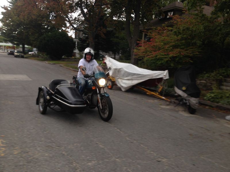

I'd like to make my '81 R65 into a sidecar rig. I can get a Cozy for $3,300 from a local dealer. I've also been looking at Craigslist with no luck. What about www.rtsidecars.com ? Any info on them?
I know BMW doesn't recommend this but I also know others have done it anyway. If I get one of these kits I'd need to fab up a subframe, right?
Any help would be much appreciated. The occupant of the 'car would mostly be my best friend Trevor:
Steven
I'd be real careful attaching any high rear mount from car to tug, the rear subframe is held on with only 4 very small bolts and nuts.  I looked long and hard at the DMC frame option and they have a rear mount setup that crosses under the frame on the main tubes then is swept back and up to pickup the high rear down to the car adds strength to the rear subframe its a better option than just using the rear subframe alone that only holds the shock/shocks in line with the frame and has very little lateral strength part of the reason cars not recomended is the flimsy subframe assembly.  My home built  frame is waiting for a better rear high mount option or a different tug.

I managed to get the Velorex mounted to the R65. It's not perfect but will serve for the next month or so of riding until winter really sets in. I've just ridden around the neighborhood so far but will get out some more when the forecasted rains end. I even took my wife out for a spin and Trevor jumped right in her lap and came along, too.

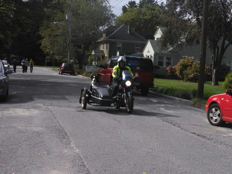

Trevor has been for his first ride of the season!
I'm very happy with the mounting kit from DMC. The car seems more secure than last year when it just had the universal frame clamp fittings.
Can you spot the collateral damage?
