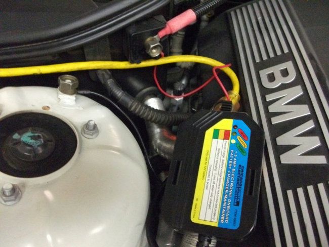

My Z3 has a positive and negative lugs for jump starting, if the battery is low on charge, they are located in the engine compartment, the battery is in the trunk .
I use a Harbor Freight battery maintainer on the Z3, three weeks of having the alarm armed and the car not driven, the battery is low enough, not to be able to start the engine .
