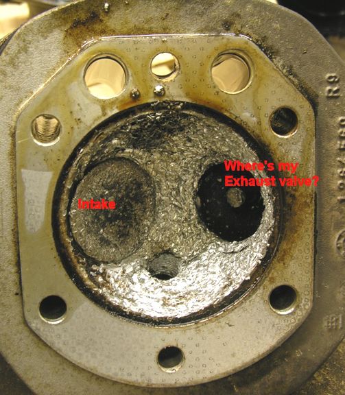

Multi-day conversation going on over on the AirList regarding a topic: "Tales of a Burnt Valve". Submitted for your enlightenment, enjoyment and edification.

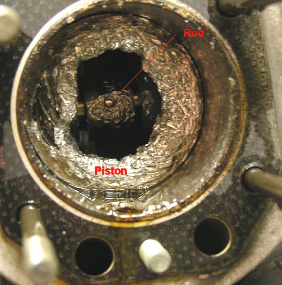

Specific bike in the thread is an R90/6, but Snowbum did post a couple photos he took of an R65 that had an exhaust valve let go. Following photos and comments are credited to Robert "Bob" "Snowbum" Fleischer.
"I have seen several R65 bikes blown up. We used to have a gal...who kept her hand well wound around the throttle...and saw the resulting mess from going up a very long grade in that throttle position without enough regards to the rpm and conditions...led to $$$ problems."
"The R65 is particularly prone to damage from lugging the engine, otherwise the bikes are reliable. One of the reasons for the damage is that the old R65's had smaller valve stems and the combustion heat is dissipated far slower at/in the valves."
"Mostly, though, it has been the larger bikes, since there are so many more of them."
 -Da Snowbum

 I think the first generation R65's, '79-80 model year bikes, also had two piece valves .
Valve recession ( valve face plastic deformation ) on the '81 model year bikes also led to valve failure issues .
When I had the heads reworked on my '81 R65, with 44,000 miles on it, I had very little time left on the exhaust valves, before they would have been pulled past the valve seats, the edges of the valves were worn that thin .
The shop that did the work back in '98, San Jose BMW also recommended that I upgrade to valves that had a thicker stem and wider valve head, I think I have valve stems 9 mm wide and intake valve head width 40 mm and 38 mm on the exhaust .

I don't think that the R65 engine is really any more prone to valve/head damage than any of the larger airheads.    Of course, one has to be smart about avoiding detonation problems (some people raised on FI automobiles are criminally ignorant of what it is or sounds like) as well as avoiding lugging the engine (which IMO is more likely to cause failure from stressing the bearings and under lubricating things more than heat buildup in the head, as heat production is a function of RPM, among other things).  But lugging the engine going up grades can also contribute to detonation issues, which can lead to problems like seen in the earlier picture
Keep up the maintenance, and, if you see things starting to close up with the valve lash, start to plan accordingly.
